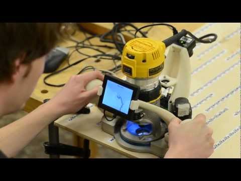

Three MIT students, Ilan E. Moyer, Alec Rivers, Frédo Durand (left to right in the picture), have created a game changer for CNC Routing and woodworking. Their invention takes a handheld router and converts it into a precision CNC machine that can still be handheld. It does this using a combination of digital camera vision and servo-controlling the precise position of the bit.
Think of it as the CNC version of image stabilized cameras. If you have a sensor that can tell which direction a camera is vibrating it can be used to control a mirror that counteracts the vibration, keeping a steady image. In this case, the camera is used to film a pattern on the wood or other material. A cutting path is super-imposed on that. The operator sees the path on the wood on the little screen. They grab the handles and guide the router along the path by watching the little screen. As you can imagine, for most people, tracking a path like that is hard, and they’ll make mistakes. That’s where the servos come in. The servos move the router bit around just enough to keep it exactly on track. Genius!
This is all much more obvious from a video than a description, so check it out:
Using the hand-held CNC router to cut out a map of the United States…
You get a pretty clear idea of how it works, and the test was certainly a torture test: cutting out a map of the United States. Lots of irregular edges but a clearly defined shape that had to be tracked well to be recognizable. The router did a great job and made it relatively easy for the operator.

- When cutting a material that doesn’t have enough “grain” so the camera can tell where it is, they simply attach tape that has some symbols on it so the camera can get its bearings. You can see such tape on the demo video and picture above.
