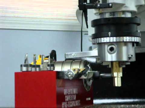

I’m fascinated by the mill-turn machines.  They combine the best elements of a lathe and a milling machine to turn out complex parts quickly that would be much less productive if done as multiple ops across different machines.  Here’s a great video of a Haas CNC lathe turning out such a part:
The secret behind these machines is two-fold:
First, they have the ability to treat the spindle as another axis, called the C-Axis.  This allows positioning the part with great position to any angle.
Second, they have live tooling.  Instead of an ordinary lathe tool in a turret position, there’s a miniature motorized spindle that can hold endmills, twist drills, saws, or whatever else is needed.
