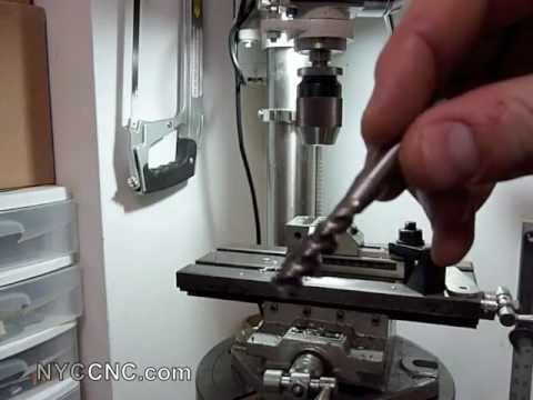

A tapping head in action on a drill press…
2. Use a tapping head. The tapping head allows some leeway for the tap to move up or down in the hole so that again, the threading process itself drives the exact speed it is going down the hole. The other advantage of a tapping head is it has a gearbox. That gearbox adds torque at low tapping speeds and also will auto-reverse the tap when it comes time to withdraw it without requiring the spindle to reverse.
This raises another issue for would be tappers: spindle control is paramount. If you are tapping a blind hole you’d better be able to stop the spindle’s rotation and reverse it very quickly lest you drive the tap into the bottom of the hole and break it. This speaks to VFD considerations like making sure you have a breaking resistor.
There are some issues with a tapping head. They’re not compatible with an automatic tool changer. Related is that they require some setup. They have a stop bar, for example. They’re bulky and use up a lot of Z travel. As the video mentions, you’ll need to adjust torque as well so the slip clutch will slip without breaking the tap. There are some advantages for a reversing head, even for rigid tapping, which we’ll talk about, but in general, the old-style bulky tapping heads like the one in the video are not used much with CNC.
