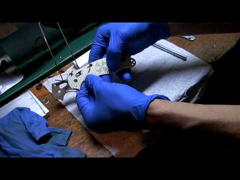

One More for CNC Knife Makers: 3 Color Anodizing + Vinyl Cutting Drag Knife
Oct 15, 2011   //   by Bob Warfield   //   Blog, Projects, Techniques  //  No Comments
Some great stuff in this John Grimsmo video on 3 color anoziding. He uses vinyl stickers cut with a shopmade ball bearing drag knife to do the masking:
YouTube Preview Image
3 Color Anodizing…
One of these days I need to set up an anodizing line and play with the results!… Read the rest
