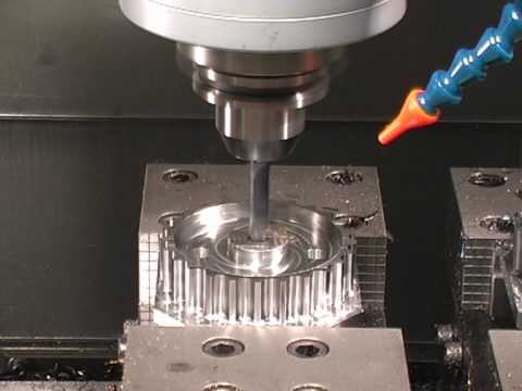

In an earlier article, I wrote about the relative merits of twist drills and interpolating a hole with an endmill.   The focus of that article was on the initial hole needed to start pocketing.  This is classically done by helixing the endmill down to depth and then proceeding from there.  The question I wanted to explore was:
Although, profiles and pockets often begin with the need to get the endmill down to proper cutting depth. Given that you know how long a tool change takes on your CNC mill, how many such plunges do you think are required before you’d be better off to use a twist drill to do the initial plunge and then let the endmill interpolate off of that?
I include an Excel spreadsheet to help calculate the two scenarios in the article, but the bottom line was an example that showed that as soon as you had more than one such pocket-starter-hole to make, the twist drill came out ahead.  I also discussed how a number of machinists keep a 1″ or larger insertable drill in their toolchanger for just such occasions.  In fact, here’s a neat little video showing exactly that approach in the making of a timing pulley:
YouTube Preview Image
