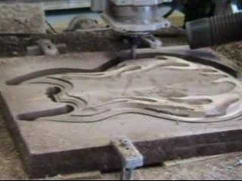

An observation: machining these materials results in some fast feeds and speeds. A good CNC router with a 15-20K rpm spindle needs some fast motion to really take advantage of the speeds and feeds that are possible. I’ve seem some video of some of these machines and it’s a lot of fun to watch how fast even the shopbuilt units move:
YouTube Preview Image
Routing a guitar body on a homebrew CNC router…
